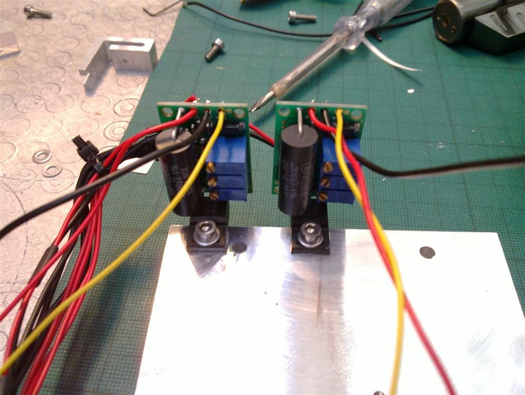

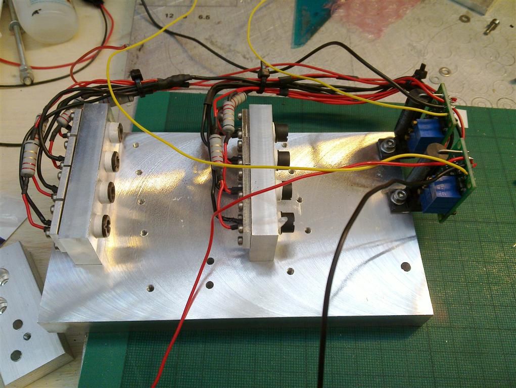

I'd suggest adding it for all diode types, just to be sure. It's not necessary in all installations but some users have reported capacitive coupling between the first diode in the set and the casing which can give it spikes because it's riding at a high voltage relative to ground and the other diodes.
I'm planning a 'break out board' for the new driver to be used with series setups that will simplify all of this.
