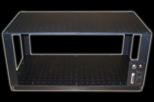

    I just "finished" my RGB in a LT-1000 case but Im running into the problem of how to hang it from truss. It DEFINITELY needs to be supported from the bottom of the case and thats where im running into problems....
    I had thought of 2 possible solutions but want to hear what yall have to say.
    The case is 30in x 20in x 12in and around 80 pounds
    this was the first thing I thought of but is kinda expensive....
    then I thought these may work also.
    So what do yall think? How would you hang this case?

    ... for 'base support' I'd make up two 3/8" > 1/2" thick x Width of your LT, + 2", either- side, aluminum 'rails', and use 'heavy' (5/16" min; 3/8" better...) threaded-rod + double-nuts, top/bottom to make a 'box-clamp' around it, if you're just looking to prevent 'flex'...
    IF you need to 'hang' from the base, this can be 'tied-in' to the 'pipe' design, up-top, ie:...
    ...Use your 'imagination', but do anything with at least 5/16" min; 3/8" better, 1/2"-thick, best, stock... Make a trip to your local Pro-audio / lighting shop and think 'hardcore'... (I would not really recommend 'off the shelf' proj-brackets, etc...)

    If I was doing it I would probably run a couple of M12 studs right the way through the case (maybe in the corners) with forged eyes at the top end and suitable lock hardware at the bottom, then a couple of slings and shackles, job done.
    Depending on the dimensions you MAY be able to get "dynamo" eye bolts long enough.
    Doing the half coupler thing is tricky if the case must be fundamentally supported from below, you could weld up a cage, just remember to brace it adequately, or you could (if the internals allow) drop a pair of studs right the way through inline with the centre of mass and stick a couple of half couplers on the top end (still need the independent safety however).
    I would want an independent secondary fixing point to take a safety, remembering that it it takes 6 inches of fall before the safety goes tight you have quite a high shock loading to contend with.
    All rigging should have a MBS at least 8 times the anticipated load, and remember to be careful of side loading eye bolts (the rating drops massively). You will want to mouse or at least thread lock all the critical hardware.
    Regards, Dan.

    If you just want to fab a stand mount for the LT1000 case here is how I did it.
    I found the CG using a piece of pipe and finding where it balanced and then built a steel plate with nuts welded to the back side of the plate and got a Exterior Mounting Bracket from Guitar Center. Easy bolt on / off at gigs.

    I relay like that idea but that exterior mounting bracket looks weak. My case is probably almost 2x as big as yours and I don't think that piece could support it. Now if it was a little bigger and made of metal I think It would work great.
    If i cant find a better "exterior mount" this is the way I am probably going to support the case
