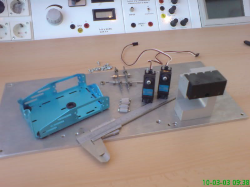

    Morning: Salvaging stuff thrown away by others has so far resulted in 7x ball bearings from 80mm fans, 3x 76x3mm axles from dvd's (fits the ball bearings perfectly), a 7x14x0.6" alu plate, 2x parallax servos, some kind of alu mounting sled for servos (anodized blue), and some kind of really robust pneumatics-mounting thing that kinda looks like a galvo-mount!

    Here's some pics of todays salvaged stuff:
    Harvesting ball bearings for galvos. (There's 2 in each 80mm fan!)
    Servos, baseplate + mount, some kind of sled (the blue thing), ball bearings + axles and some alu distance-nuts or whatever they're called.
    Mount again...
    Top of mount. I dont know if I'll use it for galvos or lasers

    Now I've got some ideas for other alu parts I've saved "just in case" . It's gonna be fun to see if it works, in that case my weirdo galvos should do quite well! Now i just need to find a proper amp-schematic and check if I've got the proper parts for the PSU-units.

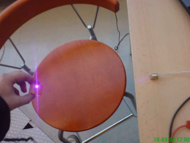

    405nm HD LD @ 110mA (burns stuff at 1500mm distance, me like!) I'm not holding a mirror, it's the little yellowish plastic box that the 20x DVD LD came in (top of next pic).
