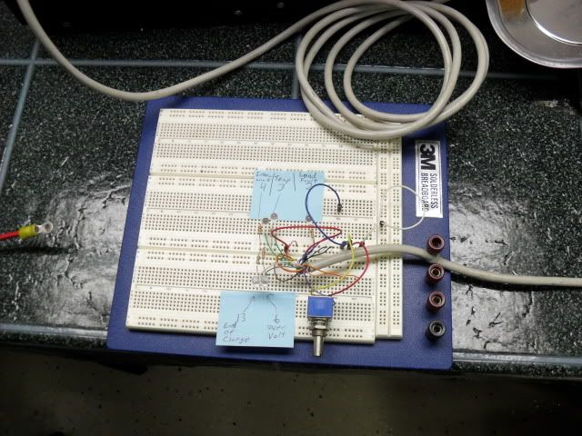

  8. #48
    Get yourself a breadboard so you can quickly wire a controller like this...
    Also, those aligator test leads really aren't rated for 1.5KV or many joules of current surge. Get some better wire and surely don't let them cross if you continue using. I can't stress enough that you can only make an accident once at these potentials.
