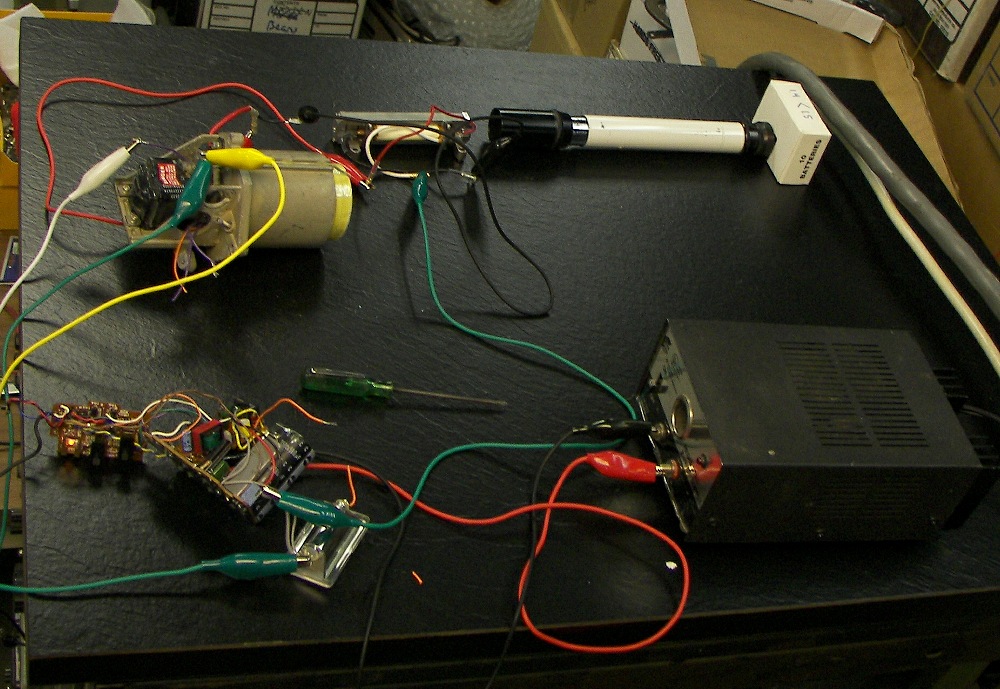

    What I have looks more like this:
    http://www.bunkerofdoom.com/ssy1/1/400_3362.jpg
    Ive got the metal thing with the cap,and charger, and the trigger.
    DJ Matt
