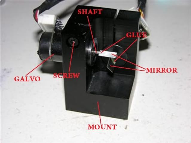

You actually posted exactly what I stopped myself from doing.... mirrors aren't glued???! How do they appear to be held in place then?
Frikkin Lasers
They are in the mount tightened by a screw.

Maybe this will clarify what norty is trying to say
