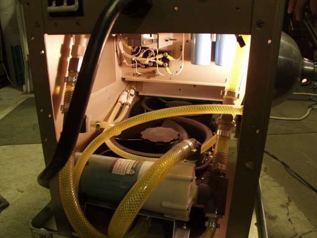

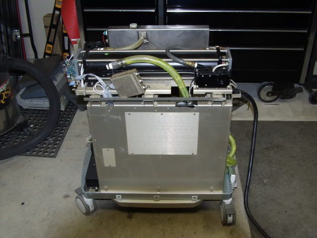

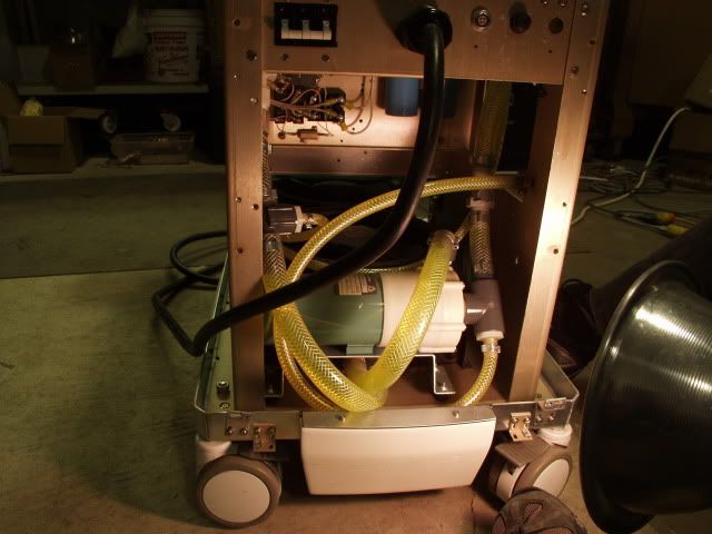

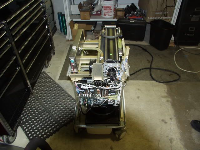

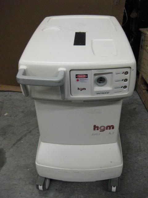

    Picked up an HGM K3 Spectrum today for a couple bucks. It's a multi-line argon and is gas intact. Sadly there was no foot pedal or controller so I have some work to do to get it running. It's a pretty neat little self contained water cooled laser with a big pump and radiator for short bursts. I have no clue if it will work CW or what the output power would be if modded for CW but it's still cool.

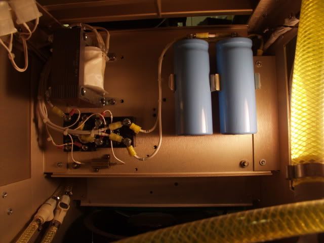

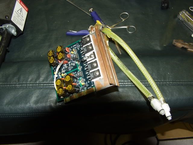

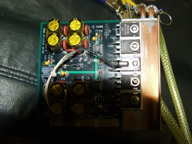

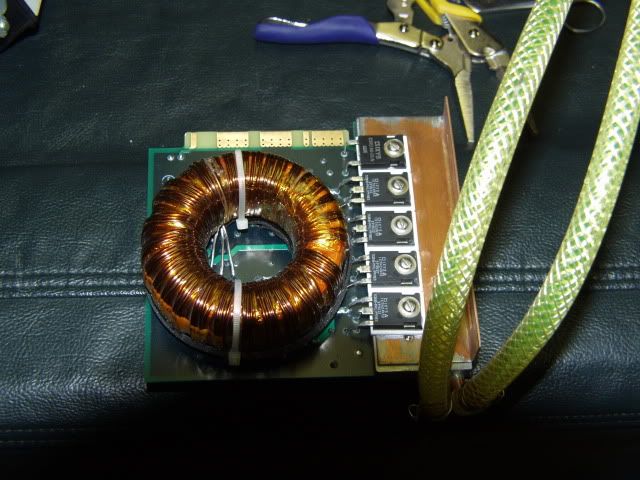

    This is actually the power supply! Well, minus the rectifiers two big filter caps and the cathode transformer. It's single phase, tiny and built for 27 Amps! So it says...
    Doubt it would do that for any major length of time.

    They use 8 of these FET's in the passbank. Not a bad little supply!!
    http://pdf1.alldatasheet.com/datashe...IXTH24N50.html

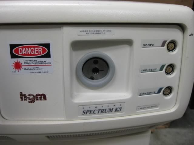

    Nice find, 300evil! For some reason, I always thought the HGM K1 was a krypton laser, not an argon. Are you sure this thing is argon?
    Yeah, this is a K3. Though, I am a little confused about HGM's model designations. None of it makes sense and they were bought out by Lumenis so it's hard to find much info on the different models. This is definitely an argon. The warning sticker says 450nm-530nm.

    Like ALL power on demand lasers, she'll run for 20-30 seconds max, and about 15 seconds in you'll see the power fall off as the gas heats up . That tube tends to run longer then the others, simply because its longer, and the model number is the board numbers inside, not what it says on the case, because HGM after the 5,8 and 20 got squirrely with the model numbers. Lumenis is even worse.. You have a K3 family... Be glad it wasnt a K4 or K6, those are lousy Ir Yags...
    The brains for that one are partially in the the concours remote... However, five 15 second 3 watt bursts during a show are not to be sneared at...
    And they made that tube in both gases, and there is a version in a same or similar case with TWO tubes, one red, one YG. See there is room on the rail for head 2. Guys, be careful when buying HGM, they made varients like crazy as fast as they could bang them through CDRH approval. There are even krypton model 5s...
