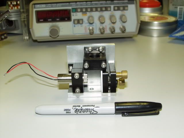

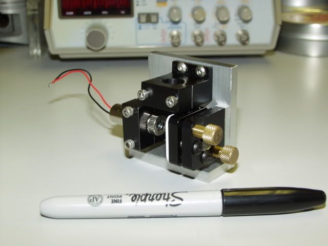

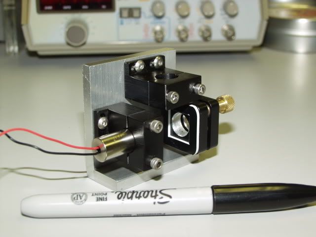

    I want to give a BIG THANKS to Pat (LaserMan532) for his wonderful dual red combiner he built for me! I came to him with space constraint issues and he built this awesome custom unit. Not only did he do it amazingly fast but for a great price as well. Check it out!
    As you can see it's not finished on my end, I told him not to anodize it because I have a little extra machining work to do on it myself. Pat even made a nice little jig the PBS cube fits right in! The whole module measures 4cm wide by 7cm deep (counting the adjuster screws) and 6cm high with a 2.5cm beam output height. SO TINY! As you can see the beam exits the module from the hole in the MM1.
    My initial plan it to equip this module with 2 LOC 660nm diodes running @ 250mW each off of a single FlexMod2 driver for an output of 500mW @ 660nm. I also plan on sticking a 40mm TEC on the back, (Yeah, overkill but it fits.) and a TEC driver for stability. Eventually I want to swap out the diodes for 2 642nm diodes for a whopping 300mW. I will post pics and details as I progress in this build. Should be awesome when It's done!
    Thanks Again!
    WOW thanks a lot 300evil! I think that is a sexy beast...however, it is a little large for our European friends. It allows the diodes to be clamped, isolated, rotated, adjusted in x and y, precision combining via PBS not scraper technology and the MM-1 gives very precise 1/4 x 80 pitch far field adjustment. Yes it is big...but it is totally functional.

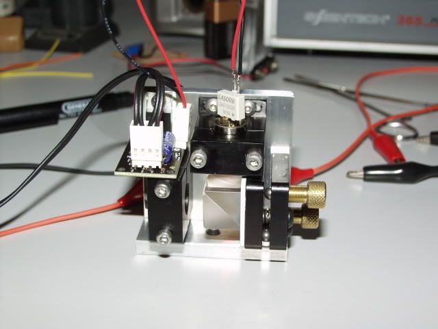

    It's a modded Aixiz module with the back half of the case cut off to .5" long to allow better thermal conduction into the .5" mounts. These have a LOC 660nm diode inside along with DrLava's glass collimator. It is also equipped with a LASORB and a 2.2 ohm 1/2W resistor for balancing. Thanks for the Resistors and Aixiz modules Sugeek!
    Here are pics of the single diode assy mounted in the combiner running on a FlexMod2. Still in the design/testing phase and waiting for my other LOC diode.
    Oh, and I painted the inside of the hole in the MM1 with high temp grill paint.

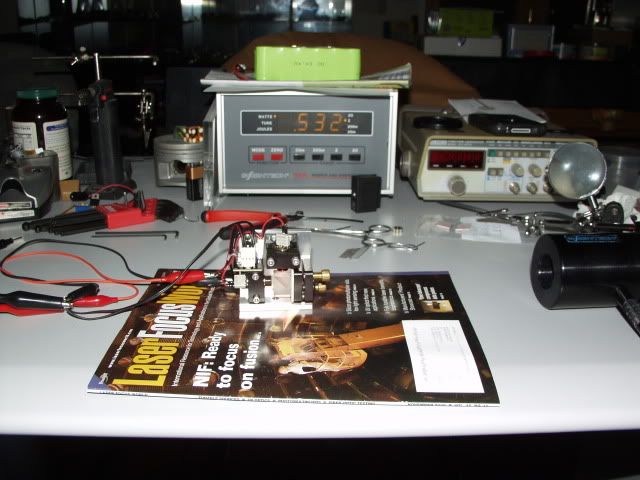

    UPDATE!
    IT'S ALIVE!
    I even installed a HUGE 40mm TEC.
    My goal was 500mW. It easily does that and then some. (See 532mW)
    Not finished yet though. Still needs the diode modules isolated and the TEC controller installed. I'm hoping to get a stable 500mW out of it using the TEC cooling.
