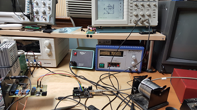

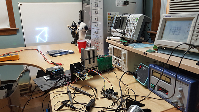

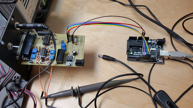

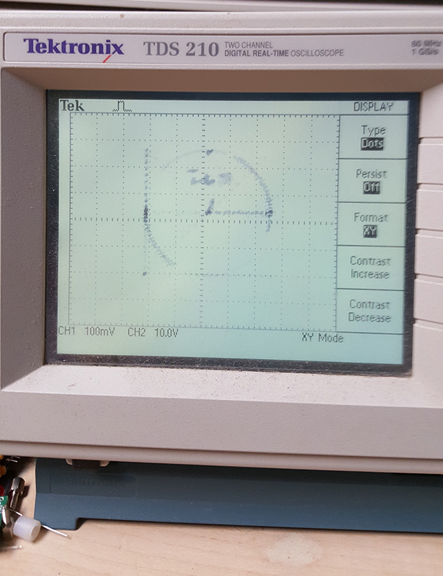

    I have a device like this on my bench right now.
    It uses a 16-bit DAC and contains the following test patterns:
    Laser Media
    ILDA 30K
    ILDA 12K
    Sharp Dots
    Blanking Shift
    Gray Scale
    Dark Color
    Grid Test
    Light Color
    Orientation
    Quadrature
    Medium Color
    It runs at an adjustable rate up to 35K.
    It's Arduino based but I'm programming it using AVR code. I'm pretty much only using the Arduino boot loader.
    Here are a couple pictures:
    It also tests shutter and interlock.
    6 buttons select patterns, functions and other options.
    I hope you found this useful.
    ED

    Thanks for posting your project. Are you able to share anything from your project besides pictures? I am curious as to what DAC you are using? It looks like one of the max SPI ones.
    I guess I never showed any pictures of the OLSD board and such. It is not 16 bit however it was designed to keep the cost down and features up. It uses an Arduino board for the controller and the boot loader. I did not use the Arduino library as it is a bit slow and bloated.
    Here is a link to the project if anyone is interested: http://www.fab-favreau.com/index.php...enLaserShowDAC
    There are some pictures as well as source code, schematics, board layouts, etc.
