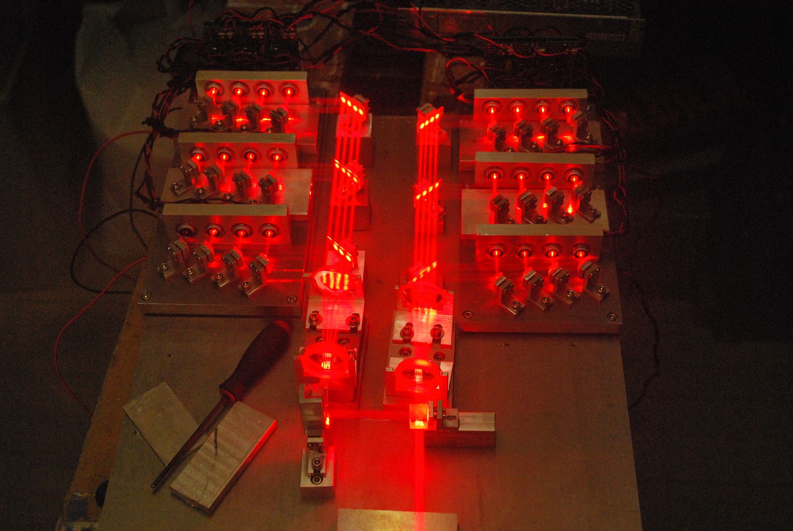

    What kind of lenses are they using to bring down the beam size in the last picture?
    Feb 2011
    New Hampshire
    3,513
    You will need to get used to replacing a diode a week.
    The lenses are probably two planeo/convex singlets with a 2:1 to 3:1 reducing magnification.

    as for lens im assuming you refering to telescopics then 3:1

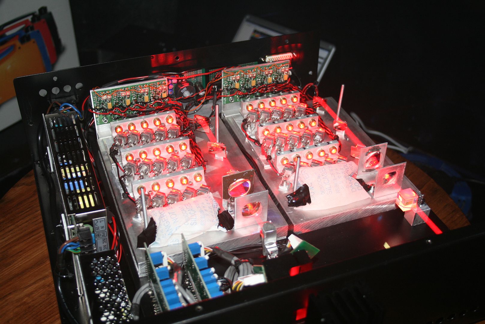

    Isnt that bottom pic one of phrizlers builds ??
