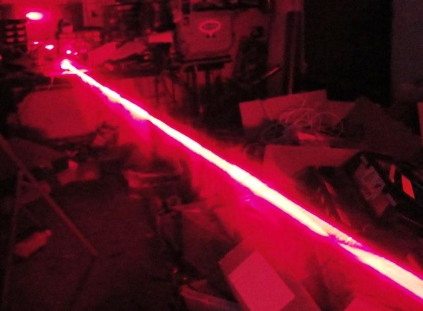

    Interesting question MrPlanters. Here are some comparison photos from G71 and P73 done in my junked-up "Lab" :
    (done with the same camera, exact same settings both photos)
    had smoke in the air, .. bottom one is different angle and possibly reflecting off of a different surface.. pooks "pink-er" to me .. dunno ..
    I couldn't get the size right so they'd be exactly the same ..
    Both cranking out over 1/2 Watt .
    G71:
    P73:

    The smoke being used in the second shot looks a lot thicker. May be skewing the comparison.
    Lol yeh it was a big fatty ..

    For my comparison pics, the P73 was at 610mW....and the G71 was at 525 mW....Both the G71 and the P73 were driven at 725 mA. My eye sez they are at the same line !!! I have no equiptment to do a wavelength analysis.....(mmm...THAT toy is also on the Christmas List !!! haha). Possibly the camera reacted slightly differently and had more red saturation with the P73 ??? Dunno ??? But they were the same colour !!! A perfect shade of RED....Now....onward to put one " On Ice "...BEAM
