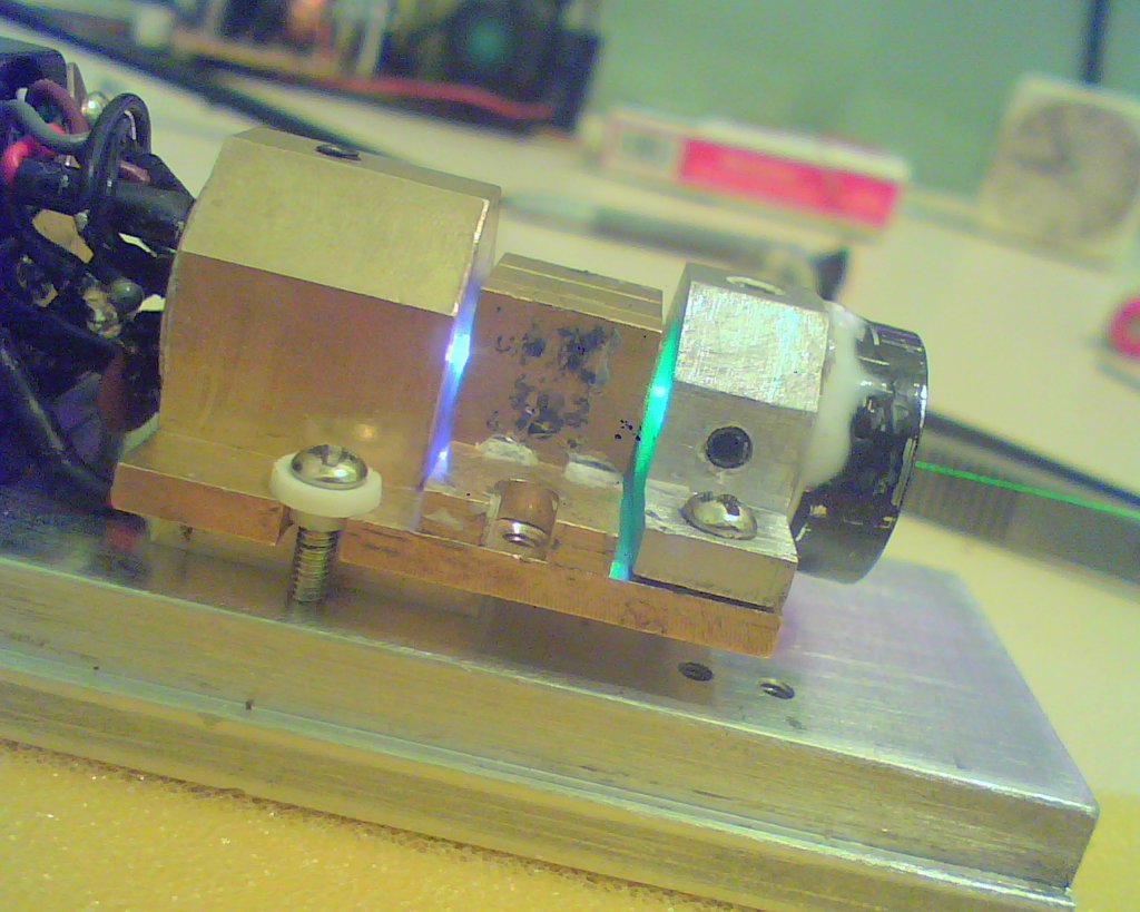

    It was a DHOM 300mW model from Spacelas.
    This is the original module inside,with single TEC

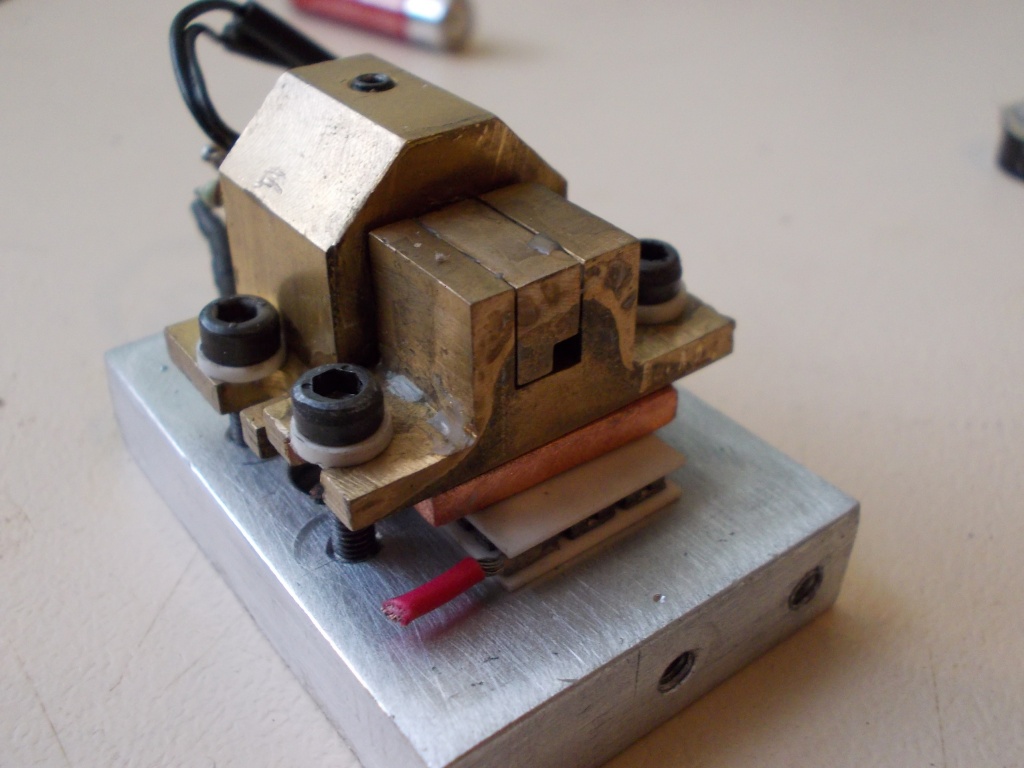

    This one is the separeted cooling DPSS

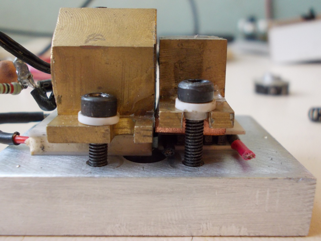

    And this one,you can see the SHG mount
    I tried to cool down to 20-25C° and heat up by the pump power up to 40C° but no result.The jellybeaning is still present.
