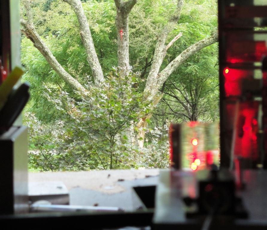

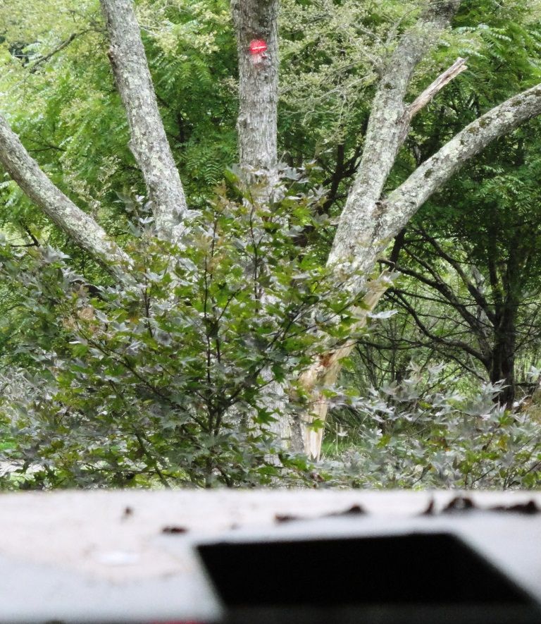

    This doesn't make any sense to me.. I dropped a P73 corrected module into my "laser-widow" (ok, I'll wait for the laughter to subside) just for shtz an grins and the farfield went to crap. Wtf?? It was fairly big nearfield but perfect dot farfield before. Then when I bounce it off of 3 45° mirrors there's a big line-- no more dot. How can just 3 mirrors do this???
    Here's just the module (with round dot on tree 100 ft away):

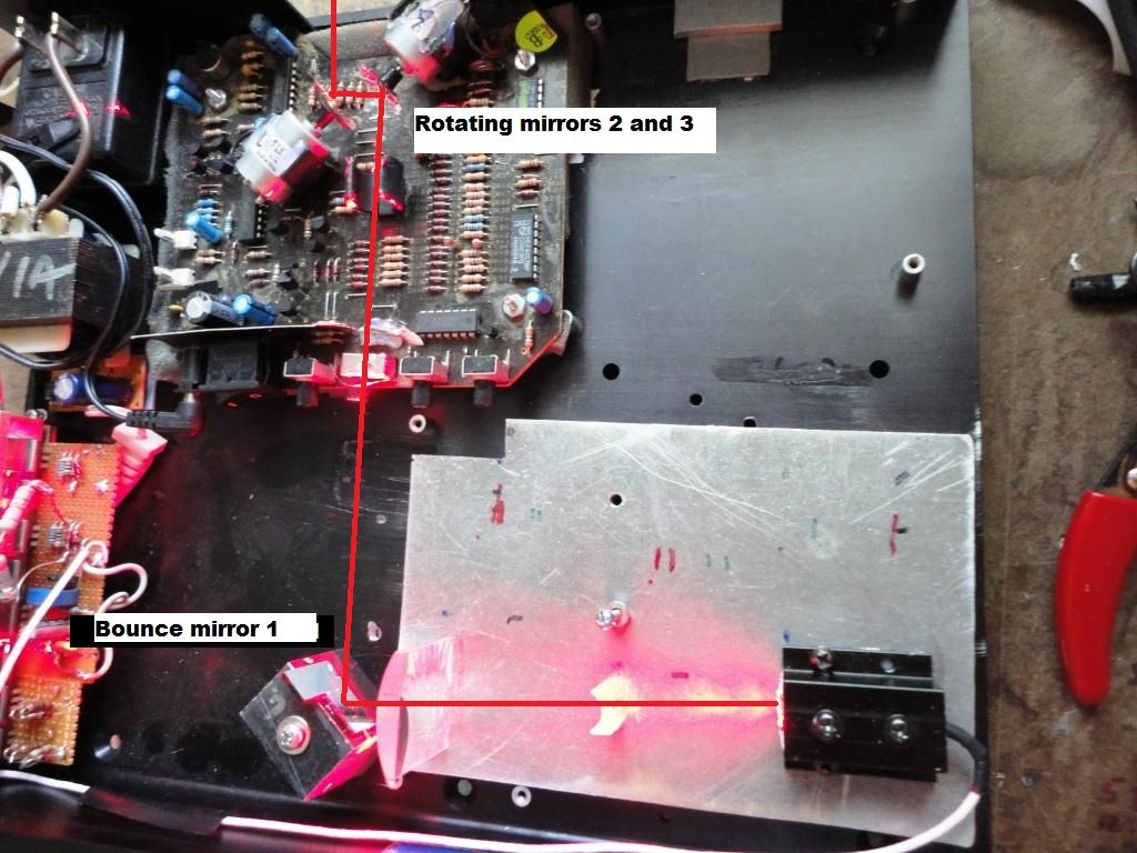

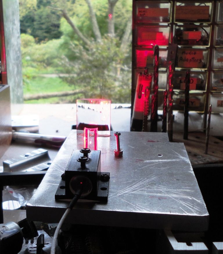

    Now here's the result in my 'projector' after bouncing off the 3 mirrors:
    Here's the 3 mirrors:
    How could 3 mirrors do this ??? (they are not rotating. pwr is off-they are standing still)

    maybe one mirror is warped?
    Quote Originally Posted by Shawnb View Post
    Hmm-- I'll check that-- thanks!
    Yep, looks like you're right Shawn, 2 out of 3 of the FS mirrors are not exactly flat. A little convex or concave I guess. That's the last time I order bulk surplus mirrors :/ Good call. Thx. Makes me think about reversing this and making some slightly concave mirrors that will turn a line into a dot :] ..Have to think about this one for a bit .. Cheerz ..
