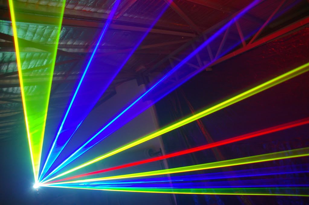

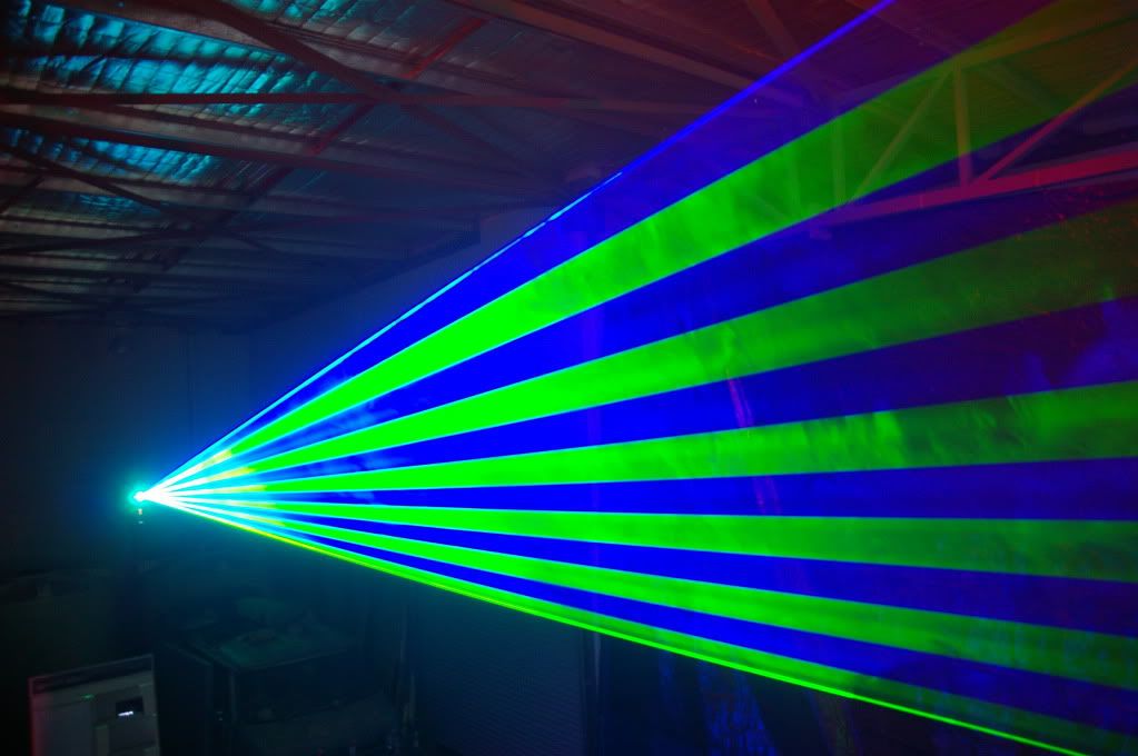

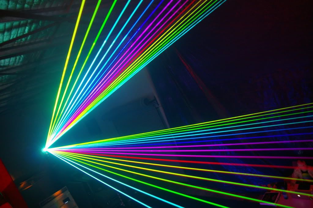

    To avoid getting slapped silly, here are some pics and links.
    I was hoping my friend with pro camera and skills was coming but he didn't turn up. So here are a few hack vids from phones
    further mangled by the tube. There are one or two still from an SLR which were sharper looking.

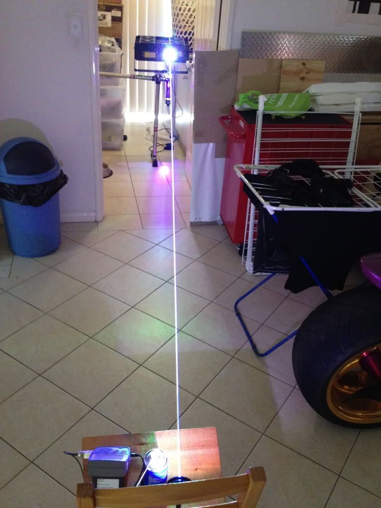

    Thanks Jon, Yes far field alignment is a snap. With Dave's interface board it's even easier. He added a real nifty feature where you can bypass the modulated signal source for each colour by way of a three push button switches. there is a pot which sets the bypass level sent to the module so you can dial down the power to a safer level while aligning. Once your set up, you just push the switches again and you are back to the DAC as the mod source.

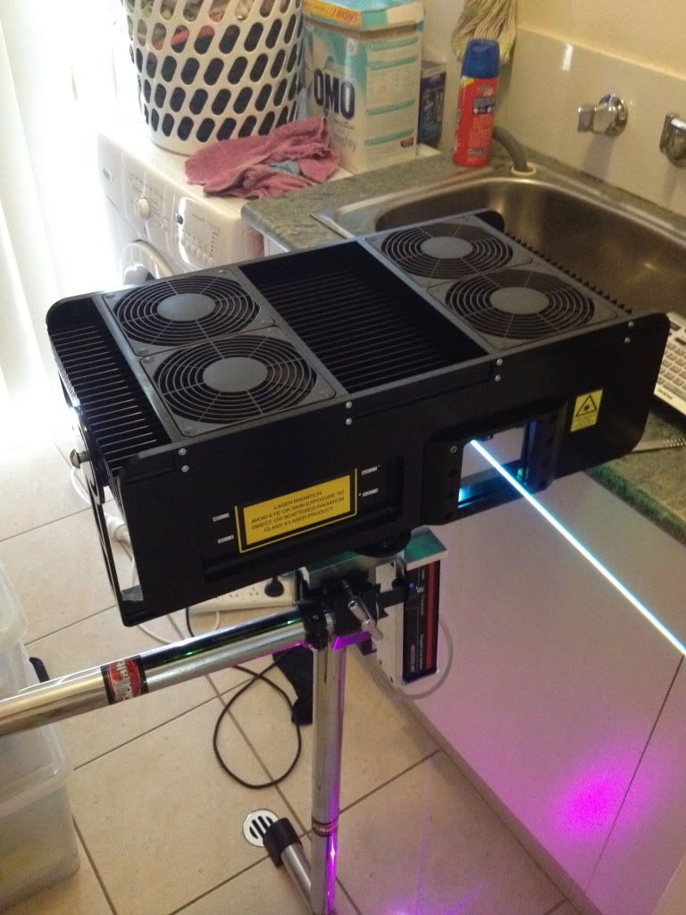

    Final power for the show was around 4.4watts. I didn't get my near field alignment spot on due to me positioning the module around 0.5-1.0mm off the centre line of the scanners. Lost a few hundred mW off one side of the mirrors and didn't have time to clean dust off the optics. Fingers crossed I didn't bake any crud onto the optics
