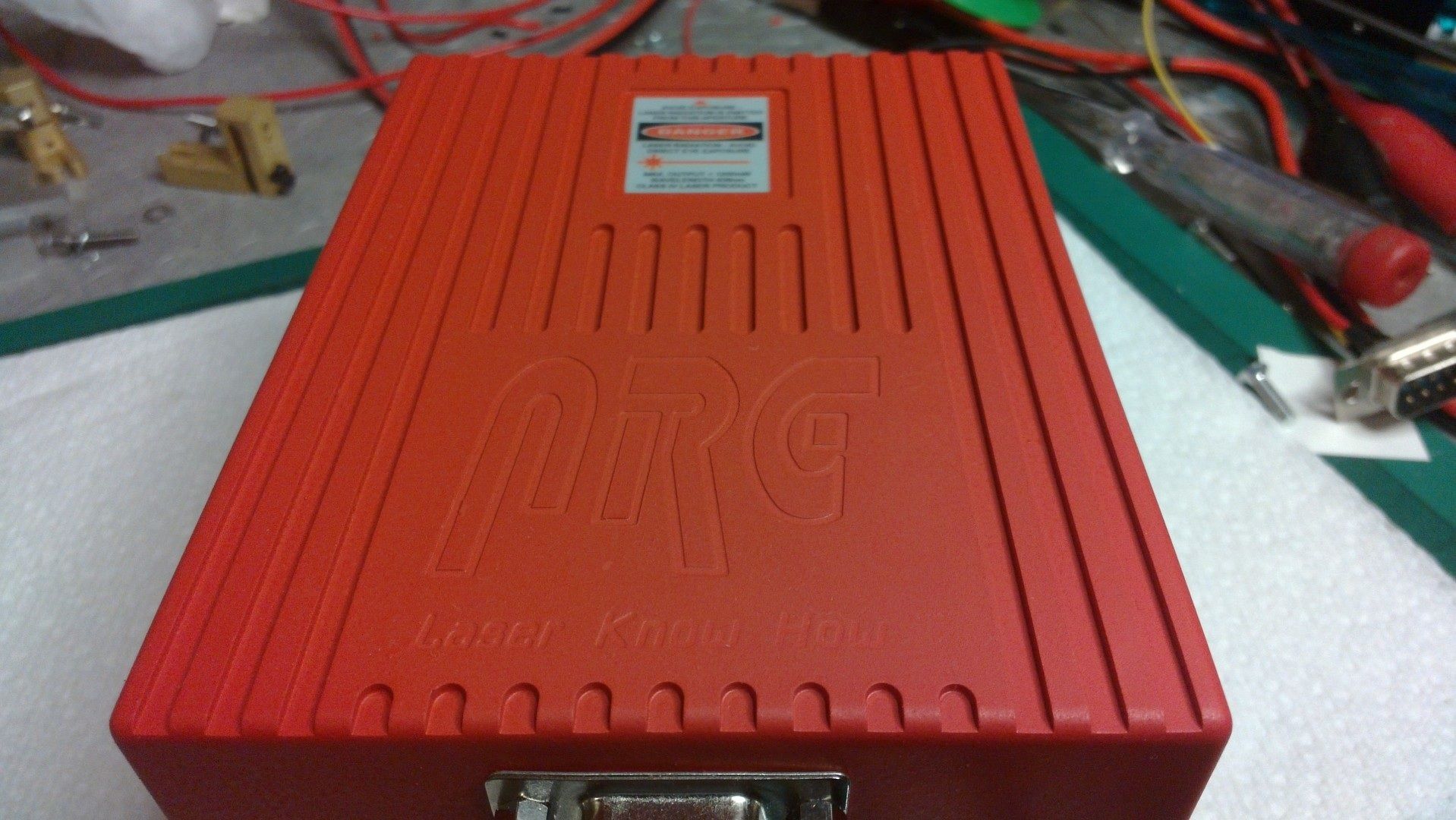

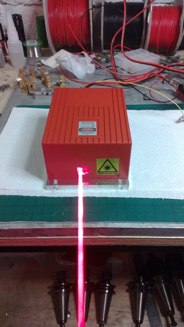

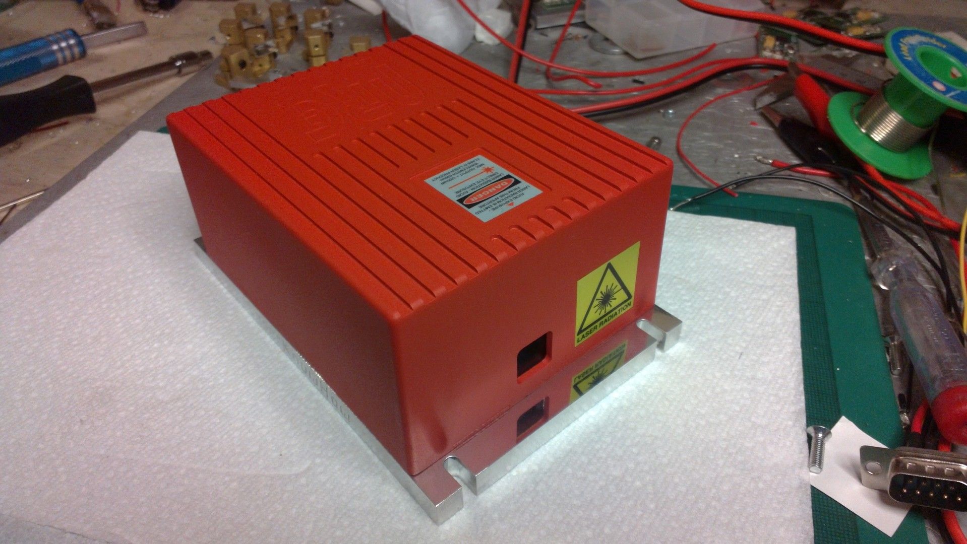

    very pleased with the results.
    its a 1.2watt 638nm module, it uses 4x 300mw 638 diodes.
    the beam is 4mm x 5mm at aperture @ around 1.2mR
    it runs on 5v @ 5amp
    also for sale so if anyone is interested drop me a PM

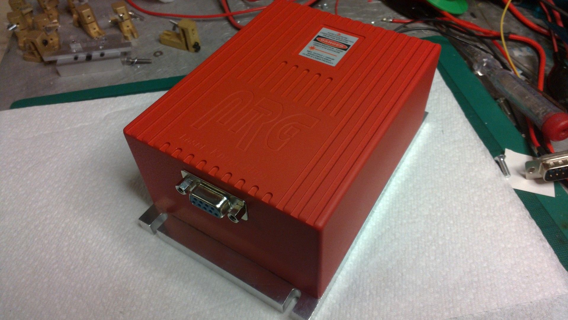

    Very nicely made. Also nice that it uses 5v. Hope my psu still has some amps over to feed my red module later
    I am wondering about the backside. Is it a port for a external driver?

    no driver is all inside the housing

    Whats the port then for? How to connect it to power supply and modulation?

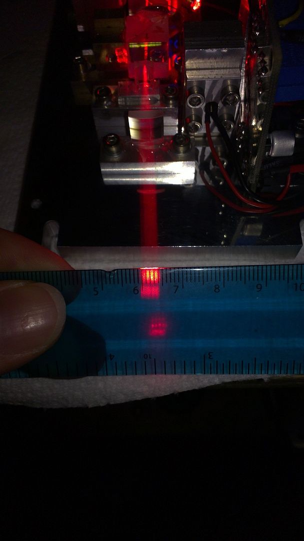

    Whats the farfield beam spot like andy ?
    Quote Originally Posted by borgqueenx View Post
    power and modulation
    a little messy, but ive never been able to get amazing crystal clear dots like single mode diodes

    I dont understand. Do you have pictures of the cable?
