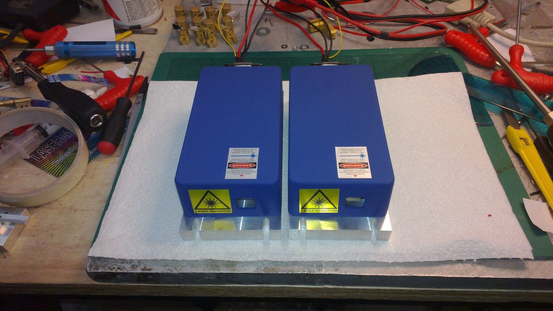

    ive been a forum member for many years, i know all the UKLM members, ive been to every one. UK members have been round my house and ive been round theirs. im not going anywhere soon, so if you get a problem with one of my modules just drop me a line and we can have a chat, its not a problem. if there is a problem with one of my modules im more than happy to take a look at it, just send it back.
    so my modules, i build everything (subject to mirror mounts) out of aluminium as its good for heat sinking, im not a big fan of brass. i dont use tec's, as the diodes dont really need them. some single mode diodes do require a tec as they have to be kepy at certain temps. run one of my dual 445 modules on full power and it generates very very little heat. mount it to a good base plate and you wont have any problems.
    i use badpips drivers in all ym modules, so good modulation and no standby glow. all modules contain the driver inside, so all you have to do is just add power.
    all modules are fully sealed with an AR window, so no dirt or dust issues
    all modules are connected via a dsub connector
    a recently blue build ive done was this pair of quad 445 modules -
    im a bit lacking in blue module photos sorry
    very simple, just 4 diodes knifed edged together, you cant correct 4x 445 beams.
    ive also done dual 445 modules in the same case, 2x diodes through a cube and waveplate and then corrected for a nice beam. the final beam is 4mm by 3.5mm @ 1.2mR.
    the module is 140mm long by 66mm wide by 50mm high

    @ andy looks nice. Added teccooling now or still without ? Good alternitive for people that want to comprimise beamspecs and power for a lower budget

    Andy_con..... I envy your mill skill
