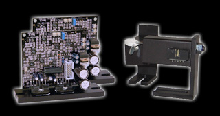

    Well... they arrived today. First observation is... I can't just replace them in the projector.
    What has been returned in the box appears to be another driver board - that actually looks like it's seen better days. They look "worn". With hot melt glue, dust and smudges, and scratches on the metal mounting bracket. The label says Model EMA 2000. The mounting slots don't mate up to the previous holes I drilled and tapped so, now I have to take the projector apart to drill and tap a couple new holes to put them back in the projector. They are certainly not "mine" that I sent back.

    Heya Cap' -
    Quote Originally Posted by Bradfo69 View Post
    Well... What has been returned in the box appears to be another driver board....hot melt glue...on the metal mounting bracket. The label says Model EMA 2000. The mounting slots don't mate up...certainly not "mine" that I sent back.
    Crikey! That's not good! Do the 'amps' look more like this one... http://www.onestoplasershop.com/images/ema-1900.jpg ? Lemme know.. I have not had a chance to get into the shop / mail, yet today, so.. If there's some 'different-amp swappage / wierdness', by EMS happening on this, I will deffo join you with the bullhorn in the picket-line..
    ...Hopefully, that was just a 'state-side mating / shipping error', albeit, neither-cool... :[ Lemme know...
