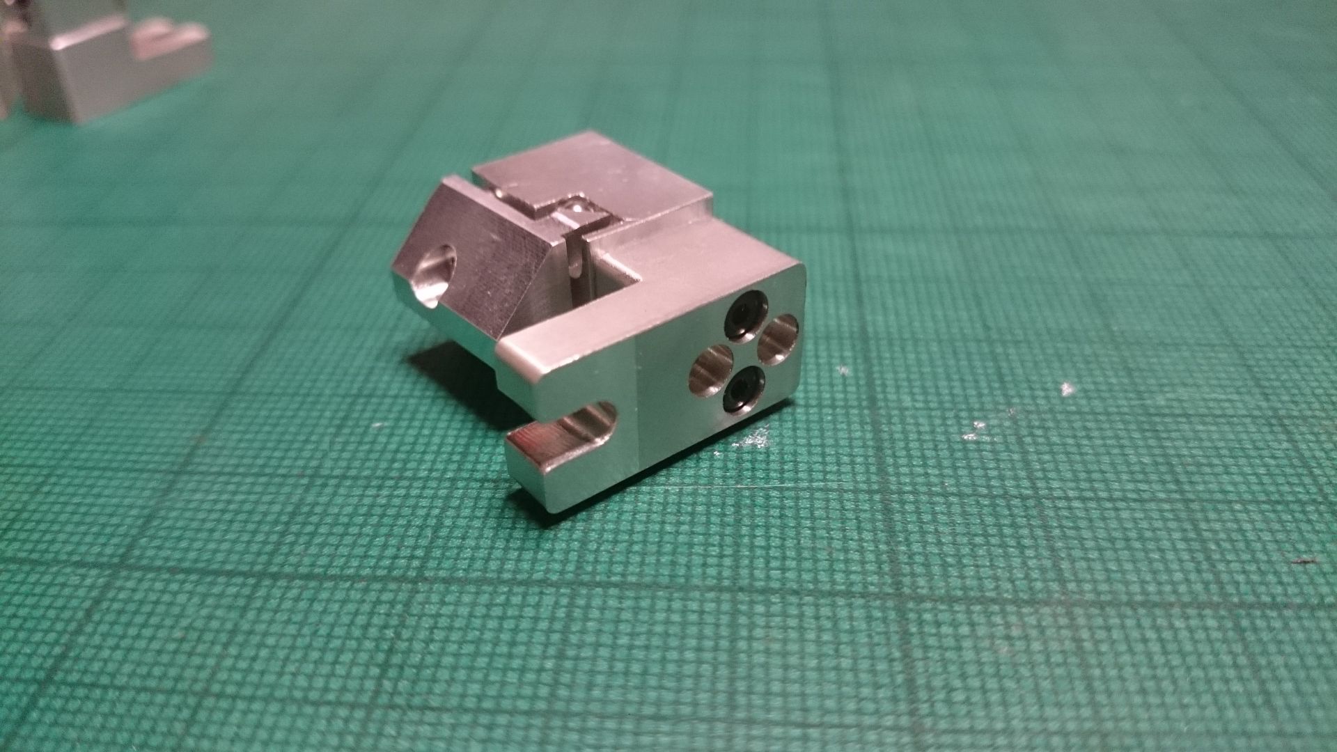

    ive been working for a little while now on a new range of mirror mounts.
    from left to right
    20mm dichro mount
    15mm dichro mount
    top adjustable mirror mount
    PBS cube mount
    standard mirror mount
    each is tensioned by a spring
    the 2x dichro, PBS and mirror mount each have 3 adjustment screws (m2 thread)
    the top adjustable just two adjustment screws
    the dichro mounts both have a 1mm lip to sit the dichro in, just add a blob of glue
    as can be seen from the photo below, the head on each mount can be rotated to any one of 4 positions (front, back, left and right)
    there are going to be some additional heads coming, a left and right head for the mirror mount (same design as top adjustable), so you wont have to move the head. a left and right dichro mount, rather than at the top as it is at the moment.
    will get some dimensions up later
    both dichro, cube and mirror mount are £15 each
    top adjustable is £20 each
    plus postage on all
    all comments welcome

    WOW...These do indeed look beautiful....each...a functional works of art !!!!! Good price too !!! Do post some dimensions , please.....for I am always short on space ....and that would be good to know....even just the base footprint !!!!! Thank you !!!!!
    dimensions
    top adjustable
    cube
    20mm dichro
    15mm dichro
    mirror
