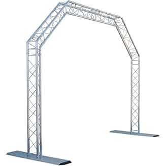

    I'm currently considering a “crank-up truss system” for two main reasons:
    1) there's two tripods instead of one, more feet means more stability
    2) more importantly, the cranking system will allow to attach the projector frames or in case of laser the laser handle to the truss at a low level then raise the tripods with the cranks. No need to attach the equipment on the ground and raising the whole tripod from laying position to standing which I think is a very bad idea for these weights.

    I know there are these square and triangle aluminum or steel arch shaped truss systems used for stage lighting and audio equipment but those are still a bit overkill for our job and our small business and also many venues we work with are too small and wouldn't want something taking up that much space just for 1-3 projectors.

    Yes, a crank up system is going to be much preferred over the arch I think. We used an arch like that at SELEM several years ago and you still needed to get a ladder to hoist everything up and attach it. You're kind of limited on where the bases can go and therefore limited on where you can use it. With crank stands, you can adjust the width of the structure by adding or removing sections and.. you can also adjust for the height of the ceilings in whatever venue you are using it in.
    I went with Global Truss and have 3 - 8' sections of triangle, plus about a 5' and a 3' section for flexibility as well as a couple ST-132 stands. We've been using it at SELEM for about three years and have at times, loaded it with projectors. The one lesson we learned a couple years ago though is to distribute the weight between the back and front straight sections. Watching a few RTI Pikos with OPSL leaning forward like the Tower of Piza was disconcerting to say the least so we lowered it carefully and redistributed the weight. Box truss (square) I thought was overkill for my planned applications but is a bit more common to find.
