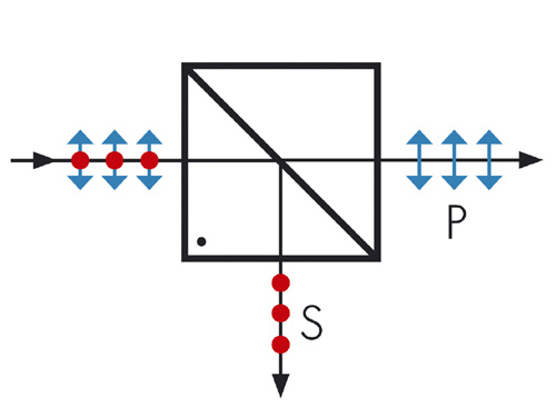

    I partially understand what your plan is. I would recommend a rotator plate instead of a half waveplate. The size might be an issue as they are 10 till 15mm in size. To combine and split you can do a rotator in 1 of the beams to combine with a pbs pass the lens setup and after that a second pbs. The second should split the beam again but i could be wrong. Can someone comment on this?

    If you combine and then separate with cubes the input and output should be the same. In a fashion they undo each other. So if you don't care if they are out of polarization in the middle of the process, your good. Hence if you start polarized the end should also be polarized. (A+B)=A+B*=(A+B) were brackets are pbs cube operation. {Eab( A|B>);|Epbs(1|AB*>);Eab(A|B>)} little bra|ket> for you. IF you want a headache look up Jones vectors and Jones calculus.

    Sounds like you got a plan then. Two cubes. One combine. One uncombine. In=Out

    You mean have one beam s and the other p polarization before the first cube? This means after the second cube the beams won't be the same polarization from each other, right? What would you use to convert one of them? I'd need something which works in the visible spectrum and has a thickness of <=0.1mm.

    They must go in unpolarized to combine and so same on way out. The use waveplate to polarize the output. 0.1mm not sure but certainly less that 1mm. All glass has some depth.
    Other way to do it is turn the beam 90 degrees. This sounds like 3d projection? Hard to help build a black box.
