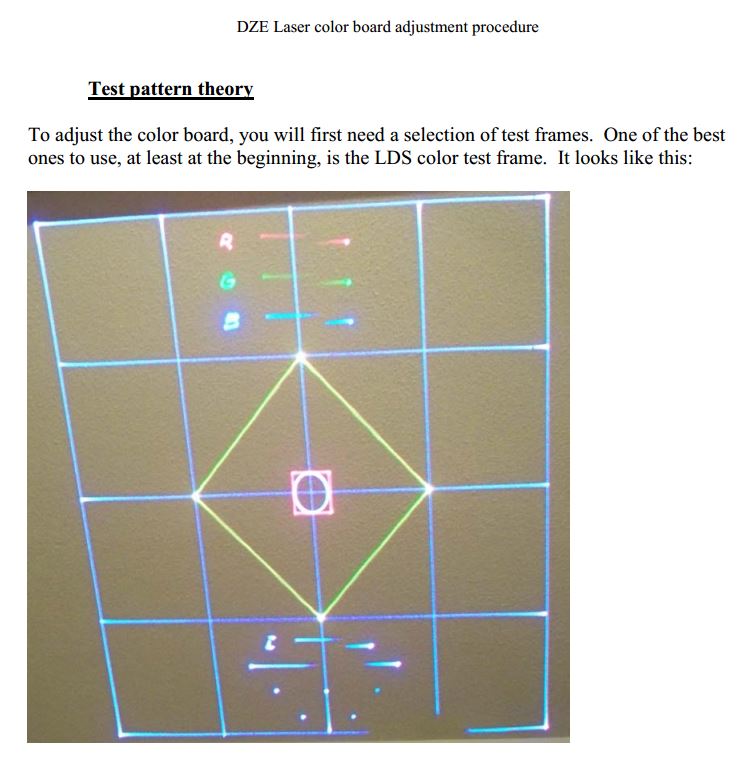

    I'm looking for the "LDS color test frame" referenced in the "DZE Laser color board adjustment procedure" manual.
    Here is a screen capture of a page from that manual...
    I checked with DZ but he can't find it.
    Any help greatly appreciated
    ED
    10,072
    That is the basis of Andrew's personal test design . Should be with LSX in a modified form , too.
    I'll check when I get home in an hour or so...
    Behave yourself and I'll get you the old Image Engineering one, as well.

    Sorry to hear about your friend. I PM'ed you last week regarding her. I know you have other things on your mind, so please don't worry about finding the frame for me.
    To anyone else, I'm still looking for the "LDS color test frame". If you know where I can find it, please let me know.
    Thank you.

    did you look on the pl ftp? might be there did you try PM to DZ?
    Oct 2012
    Carver, MA.
    197
    Hello,
    I asked DZ before I started this thread. He does not have it, or can't find it.
    Yes, I checked the PL FTP site but didn't see it there.
    I'm hoping to find this pattern (and any other test patterns for that matter) so I can wrap up the software for the handheld ILDA tester I've been working on. The hardware is complete. The software is also complete with the exception of the "LDS color test frame".

    Nov 2008
    Cleveland Ohio
    2,613
