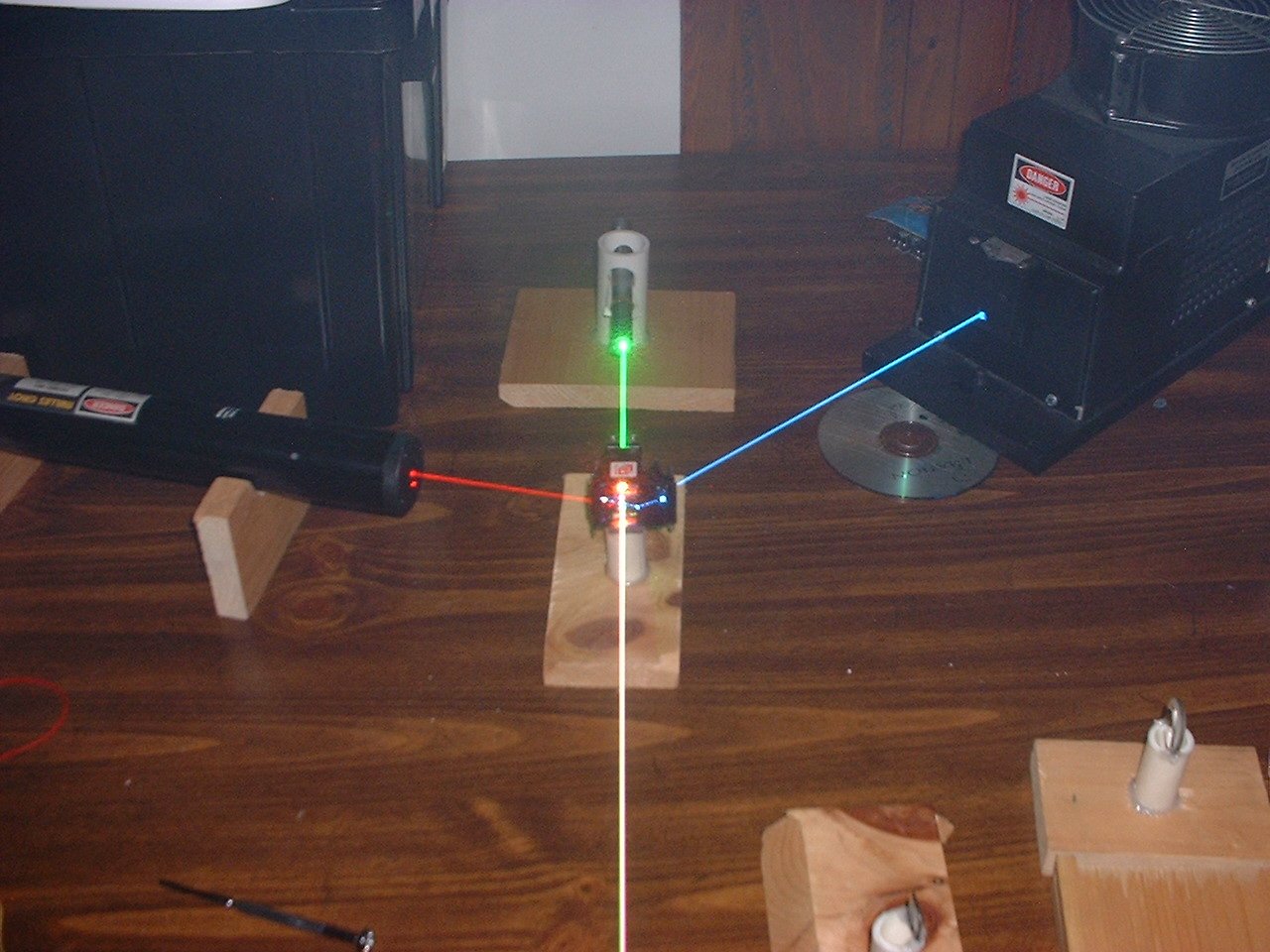

    There are several threads here on PL that talk about using color splitting cubes and trichros to combine 3 lasers into a whitelight beam. As Steve mentioned, the cubes typically have cheap coatings with poor efficiency. The famed Fujinon Trichro (harvested from pro-sumer grade 3CCD video cameras) was quite a bit better, but even so you still had to deal with the alignment issues. In the end dichros are less trouble, and often are equal in cost by the time you add up all the alignment hardware.
    Here's an old picture of one of my original Fujinon Trichros. (This photo is from ~ 2001 or so.)
    Off topic but you just brought back warm memories with that SP argon. That was my first argon. Mine was only doing 6mW but oh man... 6mW of 488nm goodness! I made "white" with my 10mW HeNe, .4mW 'Green'Ne, and my SP161. Ahhh, memories!

    Default wow-- nice mounts.
    .. is that pine... or oak? I use cedar..JK-- very true about memories..
