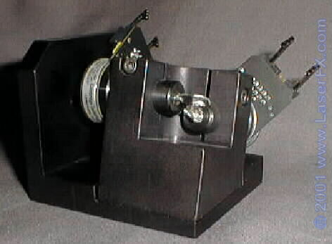

    Thats the guy I'm looking for because I was stupid and decided to mill the mount to make it flat and discovered that it's angular for a very very good reason. So any one has a source of them. Cambridge is on holiday right now. How much it is and if it would be cheaper to get my local T&D milling shop make me one.

    As an alternative you could just get a wedge made to replace the bit you got shut of. Im sure its 15 degrees - would be easy for a amchine shop to knock one up - or if you managed to mill it off could you not make one yourself?
    If I had a block of ally suitable I would mill it up for you but im in UK so not v practical...

    I have to make sure its base is angular as shown on lasefx picture about 15-20digres . Flat base is useless for me. I already have a flat base and because of angle I'm loosing good 100mw.

    The mount we sell is both left and right hand feed so the X & Y scanner pair come into the mount perpendicular, because of this the angled bottom is not necessary. We have been selling these for as long as 6800's have been on the market.
    How exactly are you loosing 100mW from the angle being wrong - or ratehr no angle?

    Because I flattened the base of my mount. I had to readjust the Y galvo to be ~55 digress instead of required 45 digress. The nature of those galvo mirrors is that they have to be 45 otherwise they start to leak the light. When I readjust it back to 45 I have no leaks but the image is displayed inside my projector case.

    Ahh Ok. Dielectric mirrors Of course I understand now.
    Im sur you can knock a wedge up no probs
