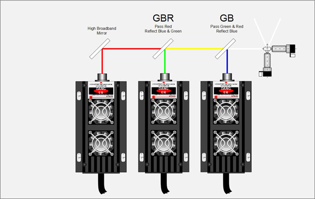

    The GB and GBR dichro’s both seem to pass red quite well (although I haven’t seen the transmission specs for them, so I'm not sure of the losses)
    So the other option for the layout is like this below, this way the beam passes through straight to the scanner and then bounces off at ninety degrees.
    For my setup I’ll be adding a broadband mirror so all the lasers are all mounted the same way

    I know layout opinions vary but for my own knowledge isn't it best to pass the green througth the 1st dicro (one that passes green reflects red or red / blue) so the laser order is green, red, blue or in other words, the colours that are the weakest are arranged so they have to pass through the least number of filters (dicros) and so suffer the least amount of loss?
    2,147,489,632
    Smile
    Quote Originally Posted by RGBLaserFan View Post
    isn't it best to arrange it so the colours that are the weakest have to pass through the least number of filters (dicros) and so suffer the least amount of loss?
    Yeah, that's the general idea. Most people prefer to put the blue laser closest to the galvos so that the blue only has to make one bounce off a dichro. (dichros reflect better than they transmit) The idea is that blue photons are expensive, while green and red ones are cheap by comparison.
    Also, typically you'll see the red laser in the middle, because compared to green, red is still more expensive - at least at higher power levels.
    But if you already have your lasers, and you discover you've got an abundance of either red or blue, then there's nothing wrong with swapping the order of the lasers on your optical table. After all, we're normally talking about a 2 to 3 percent power loss when a beam passes through a dicrho. That's really not that much.
