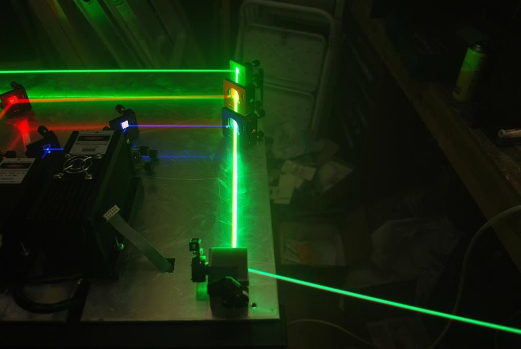

Very pretty
Mmmm... pretty colors... me like!

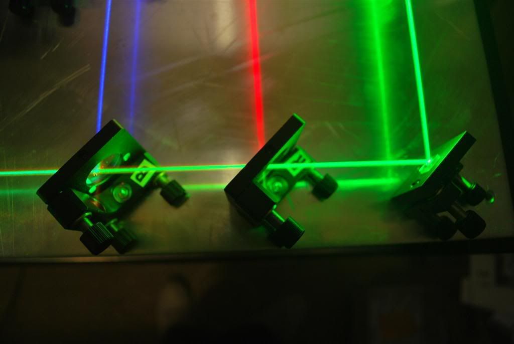

That thing must be really easy to align with all those adjustable mounts.
But, red+green+blue=green? Is that green really too powerful for the other lasers or is the camera just failing to capture the proper color?
align in 5 mins tops
my client wanted a fully adjustable beam table.
1000mw of green
1600mw of red
500mw of blue

Hi tocket,
maybe the rate is not 100% correct(sorry, Andy).
but if you carefully look the second pictures, you will see after combine the RGB and before to the scanner, the light is almost white,.

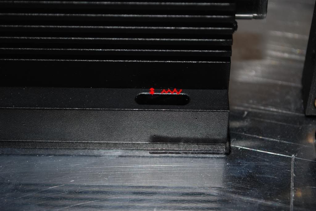

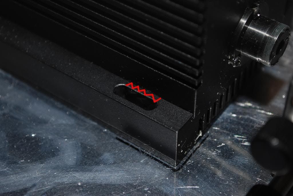

can i add a few suggestions for your new range?
the cable that links the driver and the laser head is not flexable at all. its very difficult to work with.
also the holes for mounting the lasers. on the two big lasers there isnt a problem but on the three smaller units there isnt enough room to bolt onto. see below photos.
the red is the bigger laser head where there is enough room to bolt onto to, but the green shows the smaller head where there is only 1mm to bolt onto and the bolt keeps coming off.
