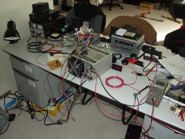

  9. #39
    FAIL.....
    Well I built the circuit in the schematic a few posts back from Sam's Laser FAQ. I can only vary the current by 10 amps so this won't work. (130A @ 2.5V) In defense of the schematic, it was designed for a particular high current switching PS that is not the same as mine. On top of all this, I smoked my digital current meter I got from China so testing is now over. Turns out the input supply is not isolated from the current metering...
    I'm at a loss here. I spent over $100 on all these parts to try and make this work but I can't figure it out. Can I just pay someone to draw me up a schematic of what I need to build to make a 0-100A PS? All this shot in the dark stuff is aggravating.
