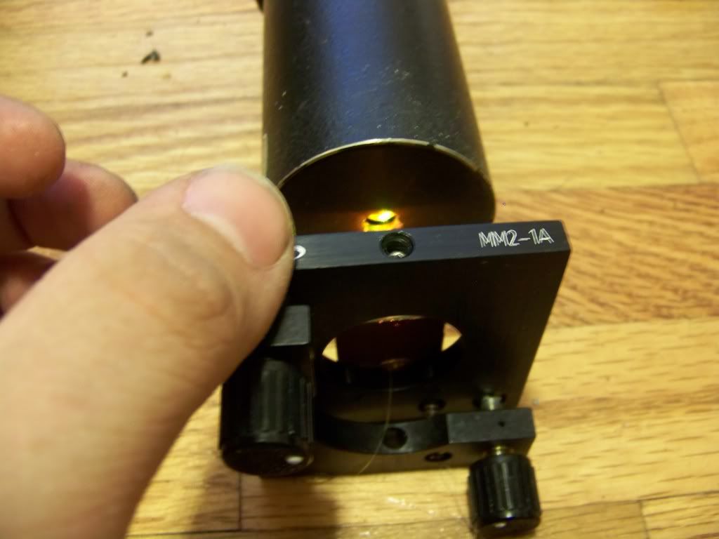

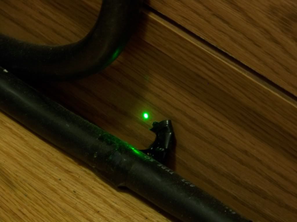

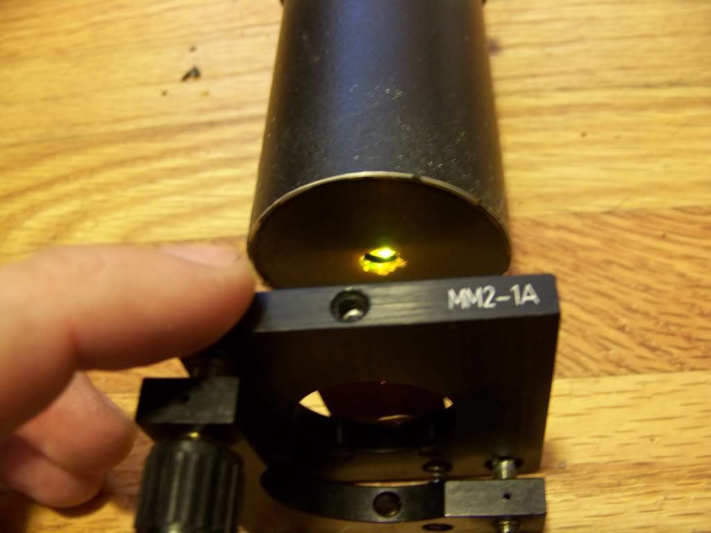

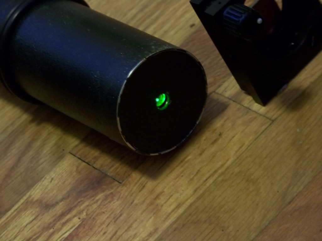

    Here ya go pat, I dug out a mirror mount and snapped pictures so you'd believe me
    This isn't even a first surface mirror, just a regular chunk of mirror mounted on a 2-axis mirror mount. It stays yellow for a second or two, then flashes back and fourth between green and yellow, then goes back to yellow for a bit and repeats. I swear when it's 'flickering' between green and yellow, that I saw some red, but it might have been just confusing my eyes due to the colors switching so fast.
    Anyway, here are some pictures.
    I love laser experiments.

    The question is, is it lasing red and green, or is it lasing yellow? If you look at it through a diffraction grating, do you still see yellow, or does it disperse?
    Marysville, WA
    855
    I'll take off the back and put a diffraction grating on the HR end and see what I can see, but I think it's lasing yellow. I think with mirrors designed to make green, it's pretty easy to get yellow but hard to get the red line to come out, but I could be totally wrong. Also, usually the green stops all together before the yellow comes out
    If you look closely in the pictures, you'll see a tiny bit of green, this is because I had to use a long exposure to capture the color, and every time I would get a good picture it would switch back to green right before the exposure finished. The flash would have just killed it.
