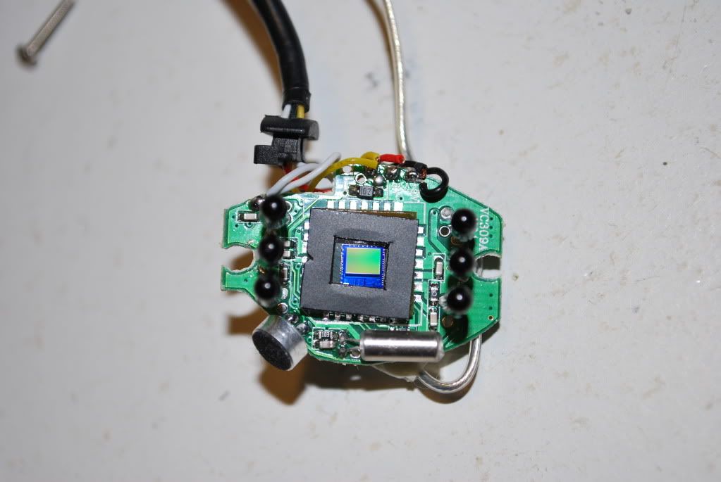

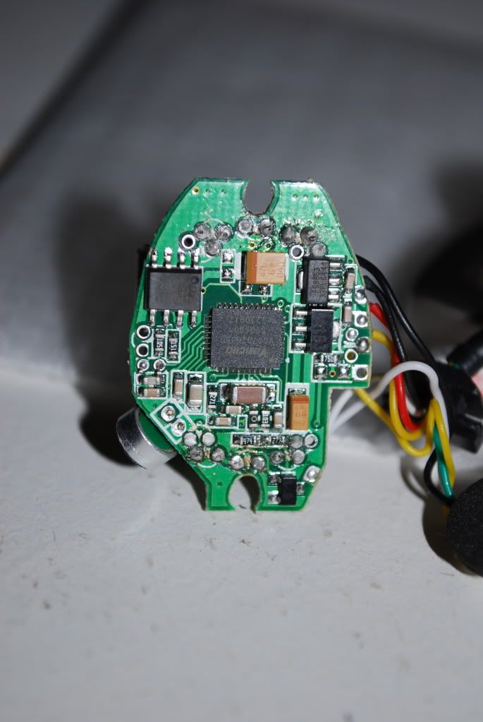

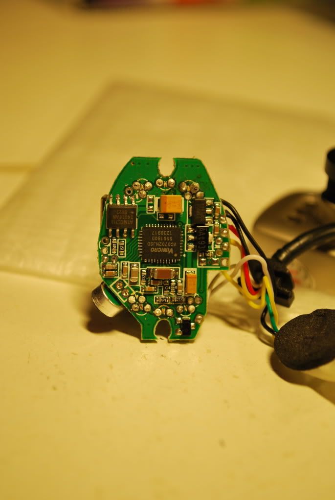

    heres a couple of pics
    it appears they are wired in series so, the whole array should run nicely with 9V.
    you recon?
    wont they be like 3v each/
    All 6 LED's in series would be like 0.6V. That may be two low so maybe two sets of three in series with a resistor per side.
