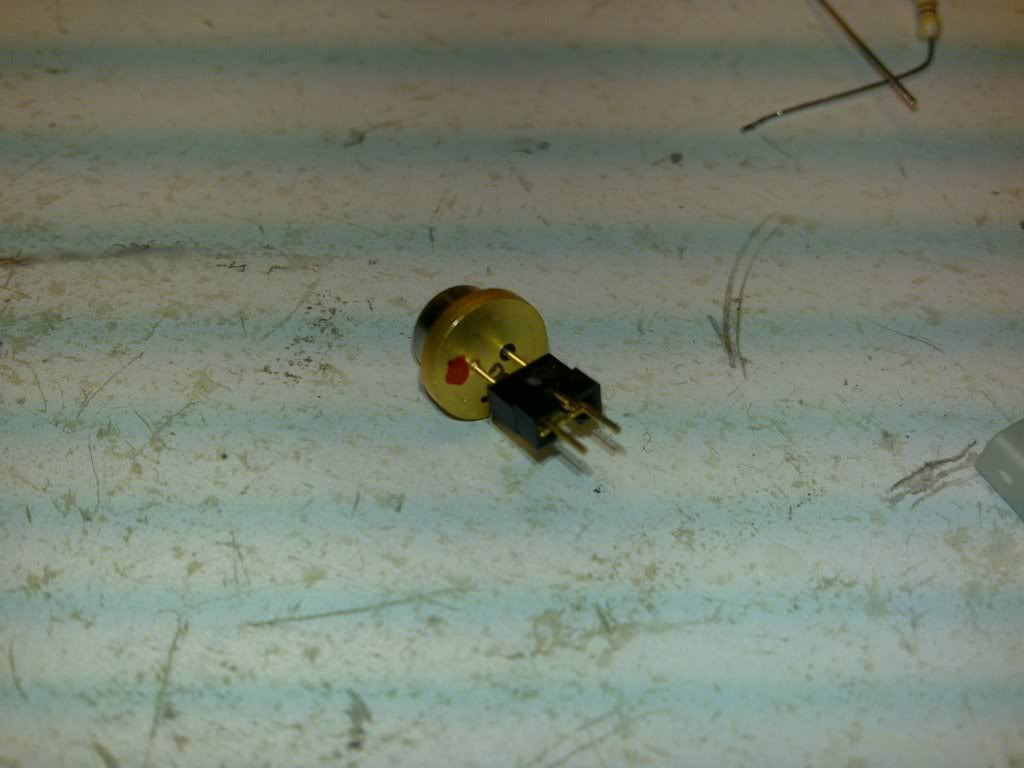

    i dont have a spec sheet for these diodes so need a little help.
    which is + and which is -??
    I guess they arrived then Andy
    Normally diodes are + to case and - to other pin (that is shorted) but this trend has been bucked by the DVD diodes but I would guess this one will be case +
    yes they did arrive, which is good.
    i thought this but wanted to double check as ive never used a 2 pin diode before and didnt know if anything was different.
    cheers rob

    If you ever want to find out that on diodes where no-one can tell you directly, shine a flashlight into it. (Or a laser with a wavelength shorter than the unknown diode emits). The laser diode will act like a photodiode, and you can measure the polarity on a voltmeter. I tested this the other day. It works. Just make sure you don't connect to the actual photodiode, if there is one, else things can get confusing.
    Thank you for the picture, it really helps me visualize the lasorb (if that is what is attached).

    Quote Originally Posted by sugeek View Post
    -Adam
    nope thats not a lasorb, that diode is a 9mm can.
    ill post a pic of diode and lasorb later
    thats a jumper to create a dead short for protection
    1,566
    I stand corrected, I thought that the lasorb was grey from the video posted by Mr. Benner in the development stage. For a moment I was excited that it would fit in a aixiz module, I guess Pat needs to mill a new diode module for us!
    -Adam

    what kind of diode is this ?

    that could be anything between 635nm and 1550nm ^^
    would go for 808nm though, as they are easily obtainable
