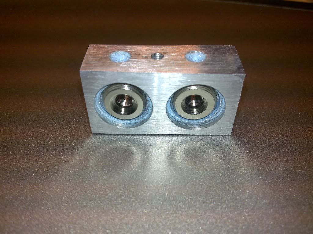

    got it off to a fine art now, measuring only 35mm by 10mm by 18mm

    I am sorry guys...but I do NOT like the epoxy idea at all.
    The chances of you getting your diodes pressed into the mount at 90 degrees with respect to each other or worse yet...pressed in horizontal or vertical with respect to the orientation of the PBS cube has very little chance of great success.
    It takes only a very small angular rotation of the polarization to loose huge copious amounts of power when combining in a PBS
    Now if the aixiz rotates inside the epoxy then...nevermind...
    I have watched this thread and cringe every time I see that epoxy.
    boy...that is a load off my chest
  3. #43
    well im gona disagree
    im yet to have an issue with pressing the diodes in at the right angle. providing you dont rush and do it properly its fine.
    There's no pleasing some people.. he scorns copycats so should be over the moon when someone tries a different method
    I do know what you're saying and it is the only shortfall, but with careful LD insertion or (as I did) a purpose made insertionmajig, this method does work very well

    if the technique is 100% reliable and 100% repeatable then it works for you.
    My point is valid. Your epoxy method does not allow one to take a running polarized diode and rotate it while watching a power meter for maximum transmission (thru the PBS) or in the other axis rotate it for maximum reflection. For optimum performance every time. You cant argue facts.
    your epoxy method is functional yet not optimum and too many variables left up to chance IMHO
    what the hell, if it works for you...go for it!
    In reference to copycats...I was talking about people taking someone's design and making copies instead of tossing the guy who invented it (i think chad) a few bucks. If one makes changes that improves functionality, features or vast price reductions then those would be improvements. But if one just makes copies to avoid slipping the inventor a few bucks just seems a tad unethical.
    EDIT: I correct myself...it was dave who has the mounts everyone is copying http://www.photonlexicon.com/forums/...114#post113114
    Doesn't affect me one way or the other.
    I would agree with that.. the diodes should be able to be rotated. You'll get pretty close just by observing the fast axis of each diode, but fine tuning it would require being able to rotate.
