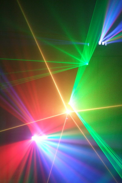

    Default I'd be probably good of with some cheap smoke machine
    Today we tested some lights at a friends with whom we'll be doing a small event in a village near our town and he has a 700W fog machine and for home testing i find it sufficient.
    on the top around 40mW green, in the middle up 60mW and below that 290mW rgy, the beams were clearly visible, guess it's sufficient for small event in a club
