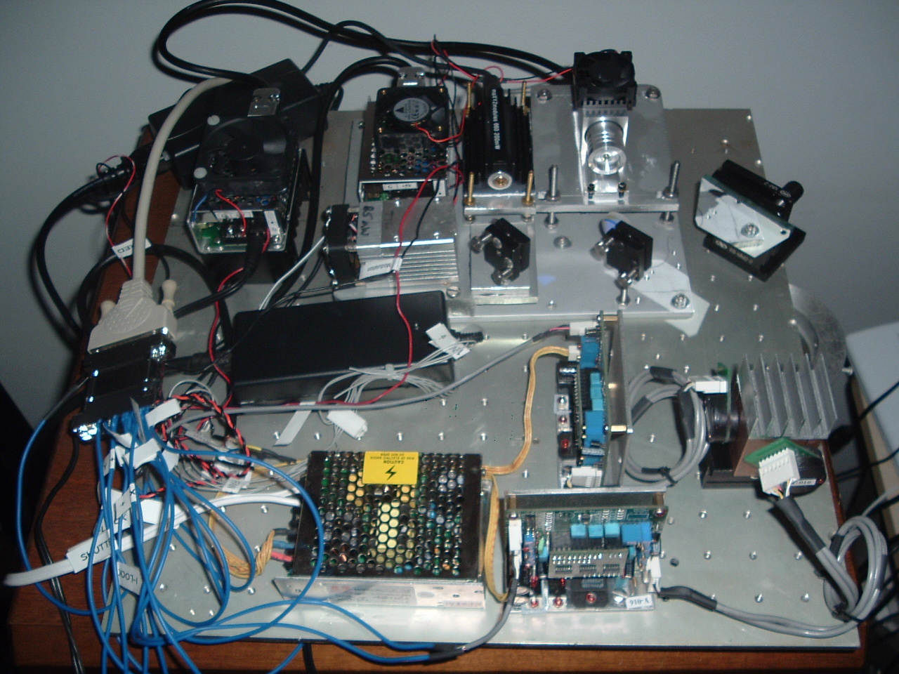

    2,147,489,632
    To expand on what I posted above - sometimes the beam heights just don't work out. (Particularly in home-built projectors where the red, green, and blue lasers could be in wildly different housings.) One solution to this problem is to use "floating tables" for the laser mounts. Basically you mount each laser on it's own 1/4 inch thick aluminum plate, and each laser table is then supported at the 4 corners by a threaded rod with a nut on the bottom (to hold it up off the main baseplate) and a nut on the top (to keep it secure).
    This arrangement allows you to tweak the beam height of the laser very accurately, and it also allows you to adjust the beam direction (up, down, or perfectly horizontal) relative to the main baseplate. It was more commonly used in the past when you had mixtures of DPSS and direct diode lasers in the same projector.
    Here is a picture from 2007 (link) of a test stand that I put together when I was building my very first RGB projector. You'll notice that the lasers are on floating tables and the scanner block also has a large shim (5/8 inch) beneath it. The MM1 mounts are for adjusting the dichros, while the large MM2 adjusts the steering mirror that aims the combined white beam at the galvo block. Having that final steering mirror allowed for slight miss-alignment between the beam height coming off the optical table and the beam entry elevation on the scanners.
    And yeah, it is super-messy, I know! I threw it together rather quickly. The idea was to test everything to make sure it all worked before I started mounting stuff inside the actual projector case. (And yeah, everything worked. My avatar picture is from some of the "first light" pictures that I took when I first powered up this test stand.)

    Awesome stuff, thanks for sharing the picture as well. It gives me ideas for how I can make it work better. I thought I would be able to cut a 2x2 block of aluminum with metal blade on circular saw (metal blade), but maybe I was wrong :/. I was thinking, if I could not cut on my own, I could give a machine shop the specs and have them fab something for me as well. I did look at the diagram but for some reason it did not register that the one view shows the beam entering and the height at which it should enter. Okay, I just needed someone to help start the gears turning in my brain lol.
